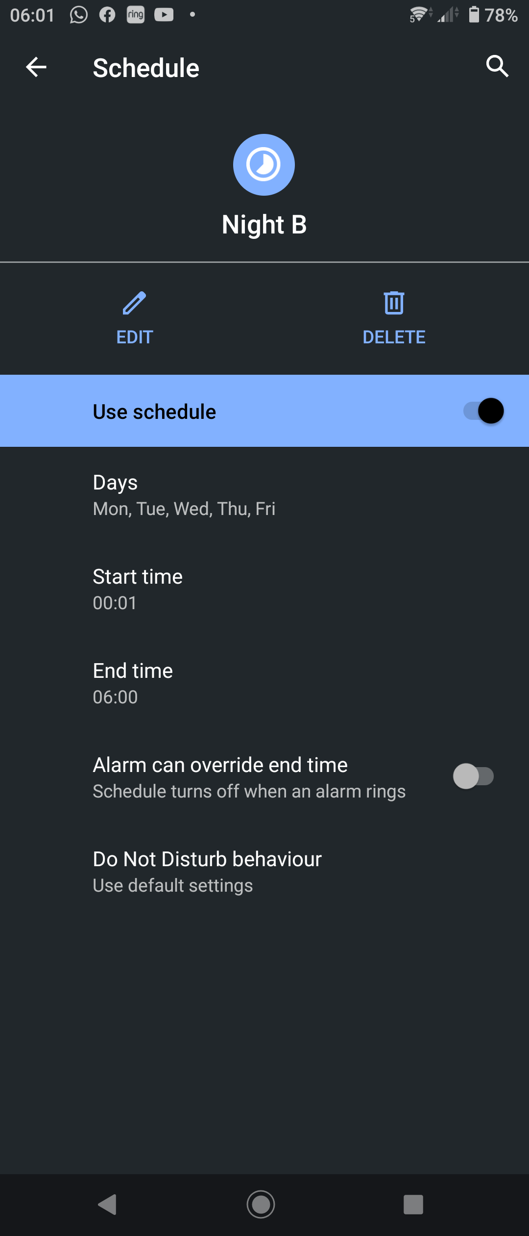

OK I just did an experiment and I created a rule that started at 20:35 and ended at 20:36, it worked perfectly. My theory is that the developer who wrote this possibly got the timing wrong when the end time is earlier in the day than the start time. Of course it says it will be the next day but then never turns it off. So I am going to try to create a DND schedule from 10:30 until 11:59 and another from 00:01 until 06:00 and see if that worked.

OK yesterday I created a short schedule lasting one minute and it worked. So I created two new schedules, one from 22:30 until 23:59 and one from 00:01 until 06:00 and this morning the DND turned off correctly. However yesterday a single schedule of 22:30 until 06:00 the next day did not turn off. I'll keep an eye on this and see if it keeps working but it's a little naff to have to do this.
