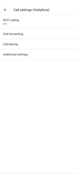

MythicSuns
I just did a test by inserting my ASDA mobile sim (ASDA mobile are partnered with Vodafone which means that their sims are technically Vodafone sims in disguise) into my Samsung S10e which has also just recently been updated to Android 12 and ran into the same issue. Based on this and the fact that nobody seems to be having Wi-Fi Calling issues on Android 12 on most other phone networks I can safely assume that the issue lies with Vodafone not being prepared for some kind of internal change in Android 12. In a way you could blame Google but since the issue doesn't occur on most other networks I would be more tempted to question vodafone's method for providing Wi-Fi Calling.
Additional: I also tried using a spare activated EE Sim I used to use in both the Samsung and Sony phone and on both phones the Wi-Fi Calling setting would reappear which further proves that the issue is with the network. I'll see if I can provide pictures as proof.
Edit: added screenshots, for whatever reason my Xperia could only get enough coverage for emergency calls whilst my Samsung did just fine but that doesn't change the fact that the EE Sim card made Wi-Fi Calling available on Android 12 which to me further proves that the issue in this case lies more with the carrier than Google or the phone manufacturer.
