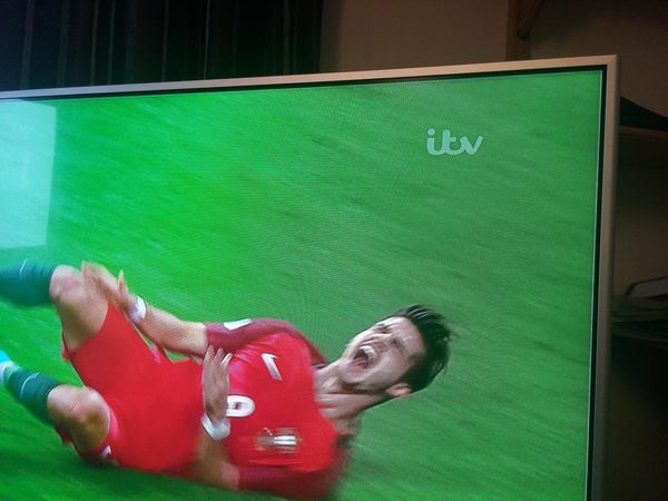

Thanks for your reply.  Here are 2 examples. The first from a Standard Definition channel.
No, when it as an old type of 4:3 Tv programme the black bars are much wider.
STANDARD DEFINITION channel
HD channel

Hi there
Thanks for the photos - I can clearly see the issue.  Can you check the screen settings to ensure that "Display Area" is set to "Full Pixel".
If that is the case and considering that this happened since the firmware - I would recommend a factory reset.  It can clear up many weird and wonderful issues.  Besides, this is also the first thing Sony will get you to do if contacting them.
If that still fails, ill escalate this thread to Sony Support.
