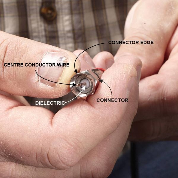

    • To exclude the cable you will need to swap the ends from the 19.2 LNB to the 28.2 LNB then make sure that you have reception from the 28.2 dish using the cable that was previously on the 19.2 dish. If this works, then we know the cable is not the culprit. Often if the centre conductor wire of your coaxial cable (on the TV-end) is not reaching at least the surface plane of the connector edge, it will not make proper contact with the female side built in the TV. Note that the centre conductor wire should also not protrude out any longer than 2 mm max from the surface plane of the connector edge.
