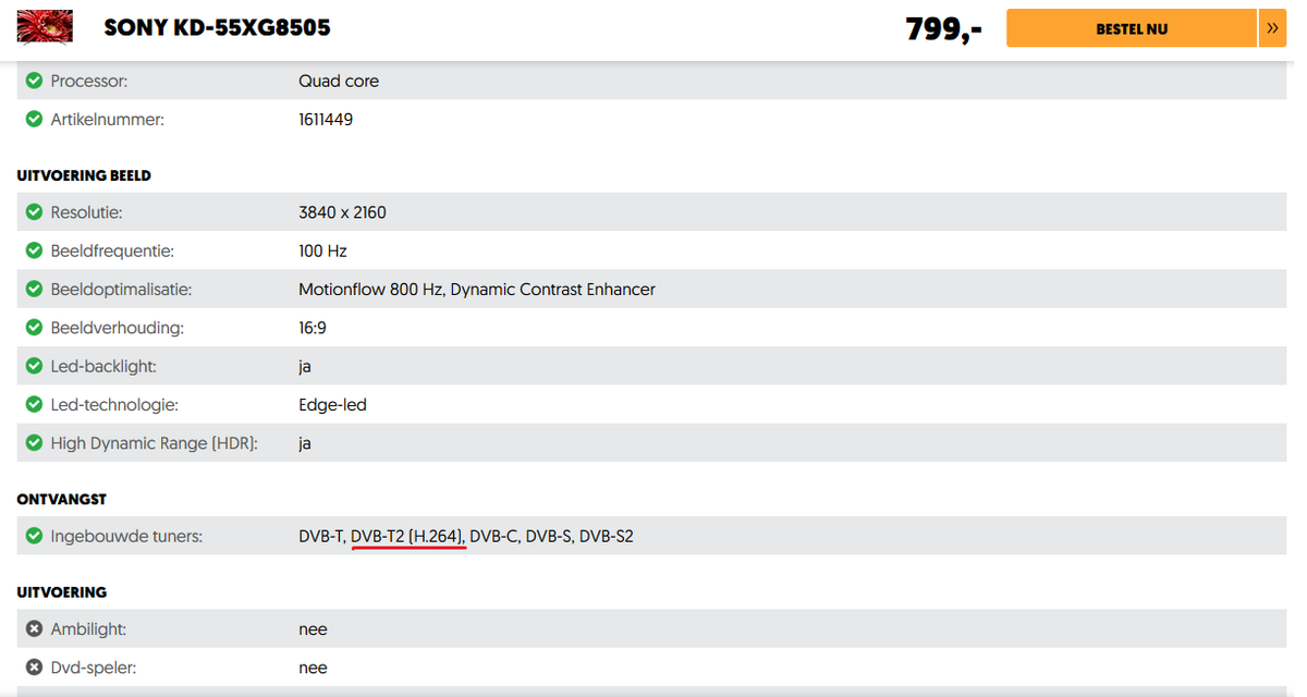

This model supports only DVB-T2 (H.264) and my DVB S2/T2 receiver supports H.265 and still works fine.
not sure that this is true
royabrown2
Hero
@kinggo01
Be certain that it isn’t...
https://www.sony.co.uk/electronics/support/televisions-projectors-lcd-tvs-android-/kd-55xg8505/speci...
  • HEVC SUPPORT (BROADCAST)
    Yes (Up to 3840x2160/60p 10bit)
Possibly @vhtne2 is not aware that H.265 and HEVC are the same thing,
H.264 or H.265 though, neither is going to do well over a €10 indoor aerial.

I didn't know that, but from the shop (Mediamarkt) I bought my tv they still advertise, you can see it here (screenshot in Dutch). I am not much familiar with it.
- Possibly @vhtne2 is not aware that H.265 and HEVC are the same thing,
Indeed.
- H.264 or H.265 though, neither is going to do well over a €10 indoor aerial.
actually I paid €25. 😀

The above shows the benefits of getting your information from Sony, rather than from retailers
