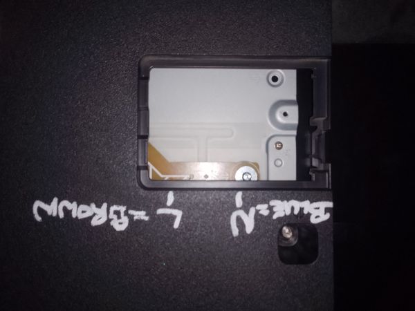

Hi, I just bought this TV and it's missing the power supply. Struggling to find out exactly what parts I need to order grr. Also the TV has been marked by someone with a cross inside a box in the second photo. What is in that area because that looks like someone's marked a fault to me. I appreciate any help. I'm from the UK.

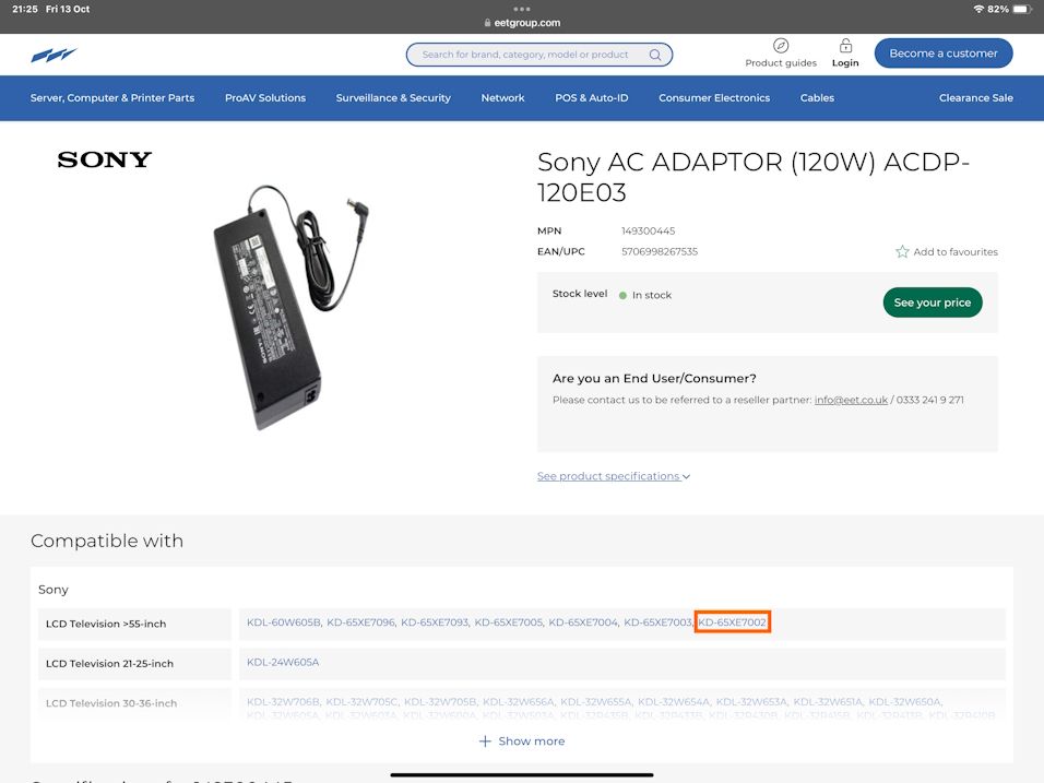

LightFoot
Specialist
Hi @Jamie65xe7002
This one is a good bet, you can always send it back for a refund. It probably costs more than the TV.
https://www.amazon.co.uk/Power-Adapter-ACDP-120E03-120W-Part/dp/B07HFHNVBL
Spare parts: https://www.eetgroup.com/en-gb/brands/sony?term=KD-65XE7002
Edit: posts crossed.
Jamie65xe7002
I don't think that power supply in the Amazon link is the right one for this TV.
royabrown2
Hero
@Jamie65xe7002 @LightFoot
No, I don’t think the brick for the 49er would have enough welly for the 65.
And judging by this, the 65 has an onboard power supply, and comes with a mains cable:-
  • What's In The Box
    • Table Top Stand
    • Remote Control
    • Batteries
    • AC Power Cord
    • Operating Instructions
    • Quick Setup Guide
    which, as it wouldn’t have been a captive cable or it wouldn’t have been listed separately, must have plugged into a socket on the set. And that seems to be the bit that has gone….

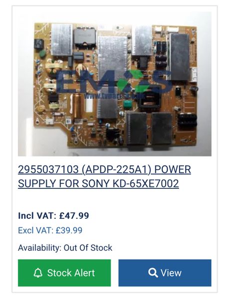

royabrown2
Hero
@LightFoot @Jamie65xe7002
https://www.tvparts.co.uk/2955037103-apdp-225a1-power-supply-for-sony-kd-65xe7002
Can’t both be right, surely?
My favourite bedtime reading is a Sony product manual…
Jamie65xe7002
Opened the back of the TV up to look at the area the x was marked but no idea if something is missing.
