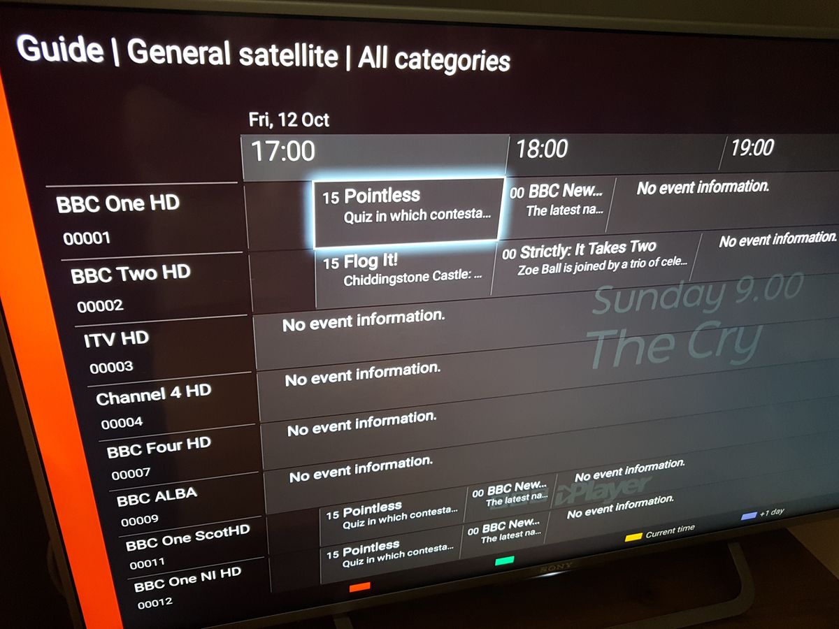

Sony told me via my ticket they would not allow me to return the TV under warranty as they can't guarantee the availability of EPG data with satellite broadcast.
They also refused my request to extend the warranty on the TV as a gesture of good will even though my local dealership offers an extended warranty through Sony for the same TV.
Heads-up to anyone out there considering buying a Sony Bravia Android TV and expecting a normally functioning EPG that you can record with, you won't get one.
Lesson learned, it's Samsung for me next time out.

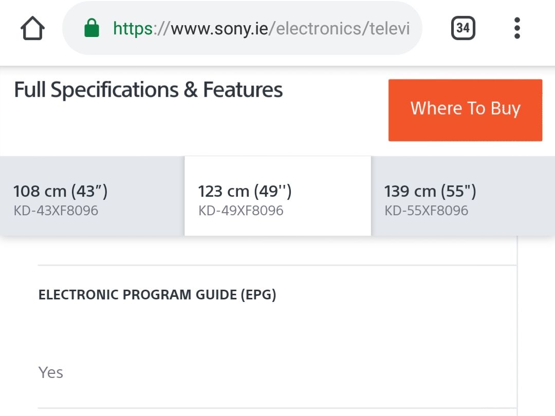

@orwell84 I just checked and you are spot on.
Sony are calling out this EPG as a "feature" on their website for my TV at https://www.sony.ie/electronics/televisions/xf8005-xf8096-series/specifications#features
Unbelievable.
I guess there is an EPG, it just doesn't contain any information!!!
