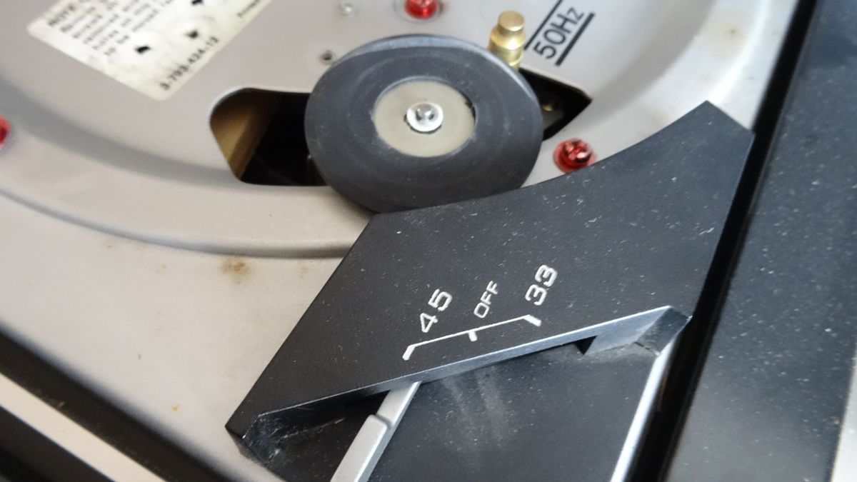

hi ive been given a vintage hp-239a hifi
turntable works at 45rpm
plays at 45 rpm even when 33 rpm is selected
seems to have a disc that touches the power spindle that should adjust the speed
dosent seem to make any difference still plays at 45rpm

5 x Red Transit screws need removeing and then stored in white label. This will release suspension system and allow adjustment of speed
