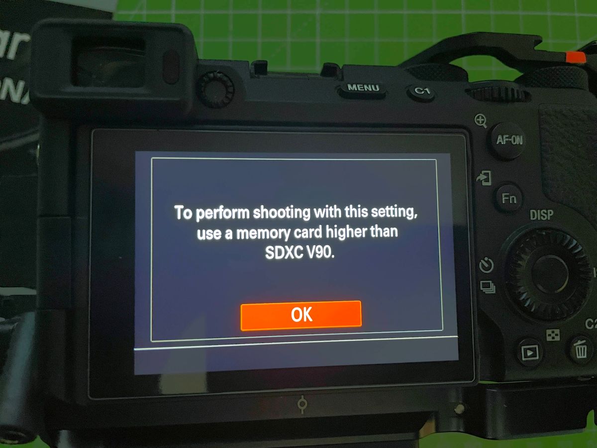

I have recently been getting the message 'To perform shooting with this setting, use a memory card higher than SDXC V90.' in video mode.
I get this with Sony Tough G-series cards and ProGrade V90 cards. Camera is set to record XAVC-intra frame, 1920x1080, 25P so not particularly high data rate.
The A7C II only has one card slot. My SDXC are the fastest cards currently available. The camera doesn't have a CFE type-A slot.
I can of course hit OK and carry on shooting as normal but this looks like a software bug?  maybe worth letting the engineering team know?

It should only be a warning message that appears as a precaution.
0073540500008048
thank you for the reply.
My point is the camera is telling me I need to use a card that doesn't even exist (yet).
It's like they have ported the software from another Alpha camera (maybe the A7 IV?) but forgot to delete this message.

I suppose that it's a software bug.
Are you able to ignore the message and take your clips?

@danardeng, @0073540500008048 wrote:
"I can of course hit OK and carry on shooting as normal"...
0073540500008048
well, a did bypass the message a couple of times but then it suddenly wouldn't allow me to record anything at all so I had to do a factory reset (which wiped all my custom settings too).
It's behaving now....but for how long I don't know?

I've sent your case to the support, probably someone will contact you soon.
Please, tell us how it's going

so, 10 months and one FW update later and I'm still randomly getting this error message with V90 cards.
To re-iterate: the concern is not just that the camera won't always accept I have a high-end V90 card inserted, it's also the fact the message shouldn't even appear at all since there is currently no option to use anything higher than a V90 UHS-II SDXC card in this camera. It's like a spurious line of code that hasn't been deleted, but one that will also stop the camera from operating.A7C2 errorOct24.jpg

@0073540500008048 did you try to reset the camera? Did you test another memory card?
0073540500008048
Thanks for your suggestion. Yes I reset the camera after the FW update. The cards I use are Sony Tough G-series and Prograde V90, both more than capable of handling the data rates required.
My point though is the A7Cii is asking for a card rated HIGHER than v90. The camera only has one SDXC UHSII slot. V90 is currently the highest-rated type of card available. The error is therefore bogus and should not exist in the software code.
