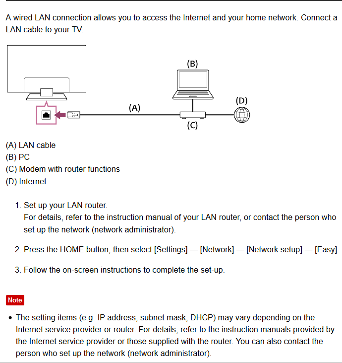

@kickboxingboy
Thank you.
I already know about this.
My query is about the "...not guaranteed for this TV".
It is as if they say "... not guaranteed for anything working on this TV"
And then what is the TV that is "guaranteed" for 10/100mbps ?
Just haven't seen this before.....:smileyconfused:

Ok you are right
But this is what should be:
and not "no guarantees". A "healthy" network should be the their only mentioning....
