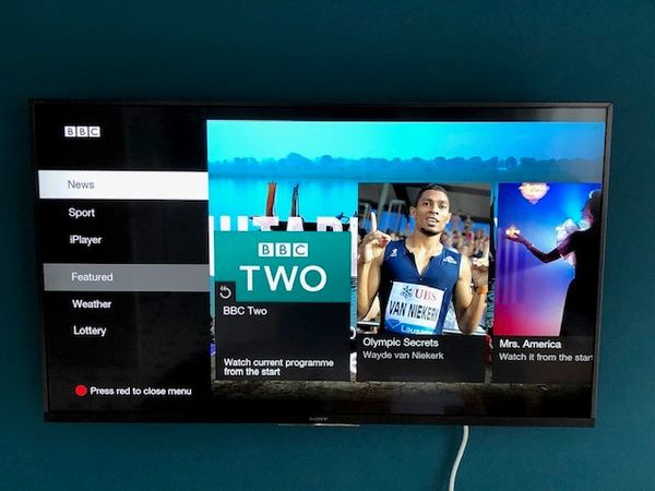

Hi Yes I am connected via an outside aerial on the roof and also via the internet if I press the red button I get the red button text on all the tvs including the Sony one but if I press the teletext button on all tvs I also get digital teletext that comes through the aerial but not on the sony tv so there must be a problem with the Sony tv as it is different from every other I have ever owned.

Ok. I'm pleased to hear you are getting the Connected Red Button version of the Digital Text service. Which is the same but offers enhanced content to the text only service. So I don't think you have a problem - you're not actually missing out on anything. Perhaps, like my Philips TV and the BT Youview set top box, they have just been designed to work differently from what went before? Who knows? Sony works in mysterious ways! Enjoy it (as long as it lasts.)
