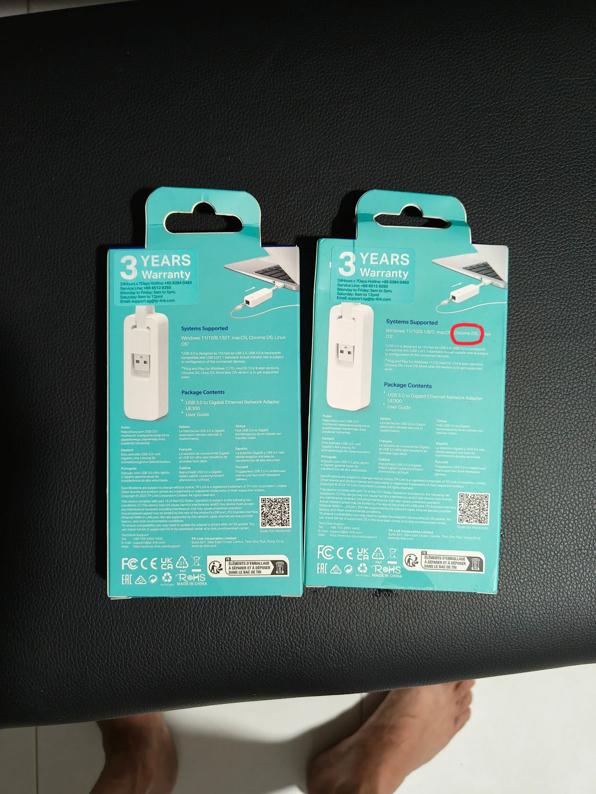

Hi,
you are right. For the newest Bravia 9 Series we need a newer USB3 Ethernet Adapter. I searched a while and ordered this one:
I tested it for one week now without any problems
