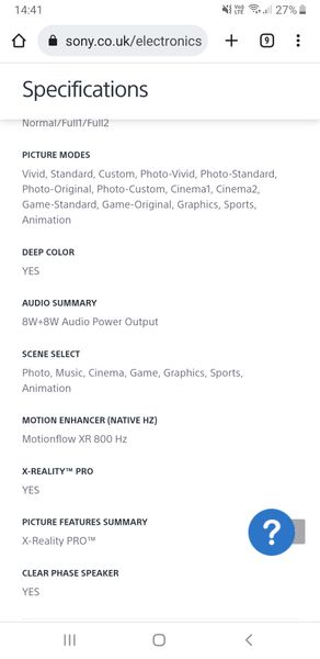

Hi @eyad85
Looking at the specifications for your TV it doesn’t appear to have a Bluetooth radio! So the chances of connecting any Bluetooth device is zero. You should explore using an external Bluetooth transmitter connected to your existing audio outputs.
https://www.sony.co.uk/electronics/support/televisions-projectors-lcd-tvs/kdl-50w815b/specifications
Edit: Sorry please ignore me, I didn’t read your question fully. The WLA-NS7 uses an Optical Digital input, so if your TV does not have a Optical output then it cannot work. Bluetooth transmitters for your available audio outputs are readily available, just not Sony.

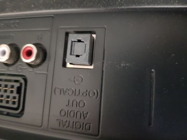

Can you show me please how it look like. And should i just looking for Bluetooth transmitters?
profile.country.SE.title
eyad85
I think i have thats it you mean "Optical Digital output" and maybe my tv is XR as i can see in the
features you sended to me.

Hi @eyad85
Looking at your Reference Guide you do appear to have an Optical output. However I cannot see any USB ports? It should work but you may have to supply an external USB power supply.
Just in case you are not aware this is only a community of customers. There is no input from Sony.
